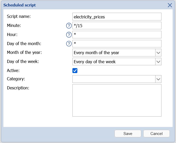

Scheduled script #
Make that your script does not fetch data too quickly (we recommend once in 15 minutes)
Scheduled script
