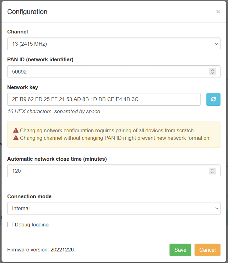

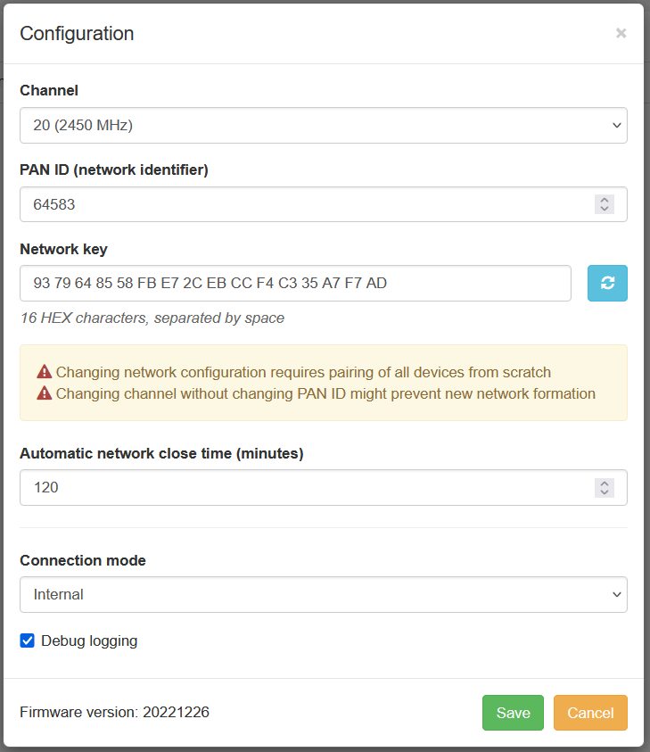

Each LogicMachine's ZigBee coordinator uses a separate Channel, PAN ID and Network Key.
LM_1_Zigbee_01
LM_2_Zigbee_01

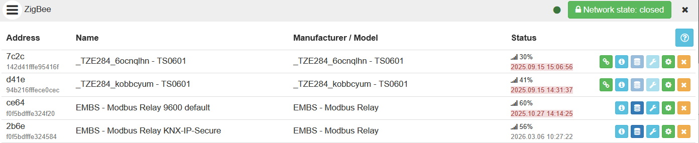

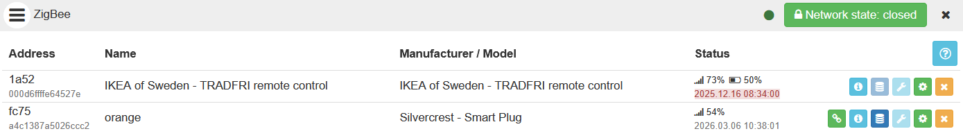

Add ZigBee devices to each LogicMachine.
LM_1_Zigbee_02
LM_2_Zigbee_02
LM_2_Zigbee_03

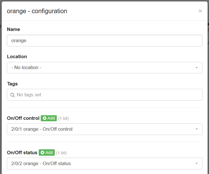

To manage ZigBee devices, create different group addresses so that they do not overlap in two LogicMachines.

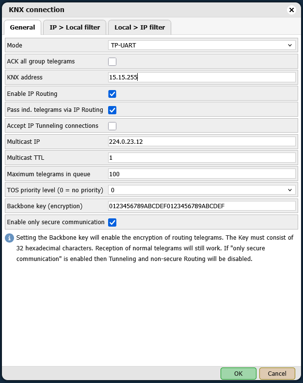

Assign a common backbone key for KNX/IP Secure routing.
LM_1_KNX_IP_01

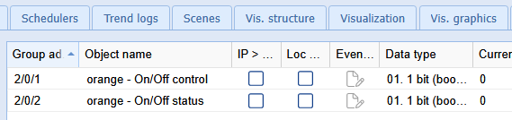

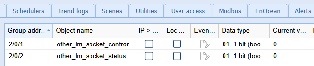

Duplicate all group addresses that need to be managed.
LM_1_KNX_grp_01
LM_2_KNX_grp_01
As a result, a single LogicMachine can manage all ZigBee network devices using KNX/IP Secure routing.
